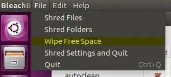

I'm trying to figure out how to run the "wipe free disk space" via the command line on Ubuntu 16.04 with Bleach Bit. It looks like the bleachbit command utility can only wipe specific caches. Does anyone have any ideas on how to do this?
The option I'm referring to in the Bleach Bit GUI
