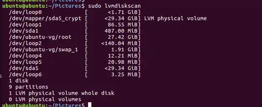

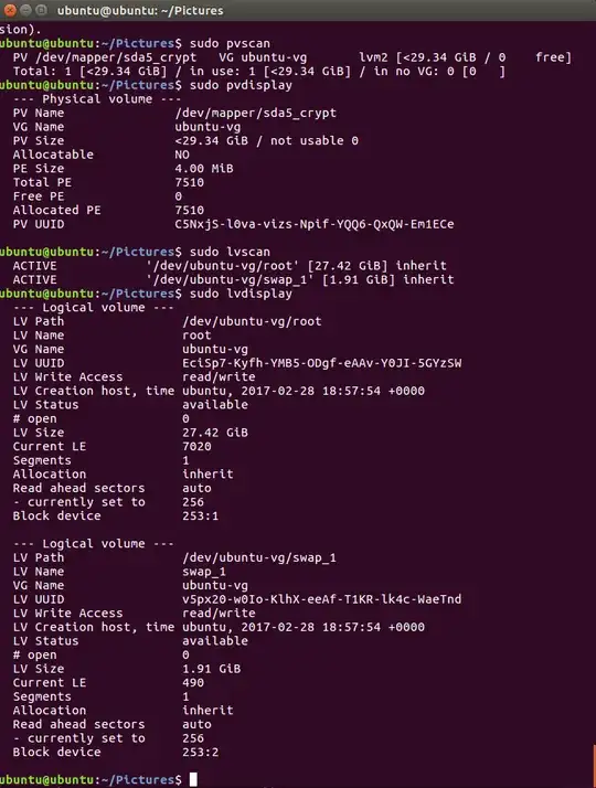

I repeated the dd and tried expanding the target filesystem with the following commands (using a live CD):
sudo cryptsetup luksOpen /dev/sda5 sda5_crypt
sudo cryptsetup resize sda5_crypt
sudo modprobe dm-crypt
sudo vgscan --mknodes
sudo vgchange -ay
sudo pvresize /dev/mapper/sda5_crypt
sudo lvresize -l +100%FREE /dev/ubuntu-vg/root
Returns: New size (7020 extents) matches existing size (7020 extents).
sudo pvchange -x n /dev/mapper/sda5_crypt
Returns:
Physical volume "/dev/mapper/sda5_crypt" is already unallocatable.
Physical volume /dev/mapper/sda5_crypt not changed
0 physical volumes changed / 1 physical volume not changed

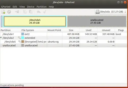

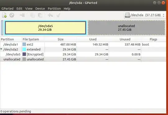

So it appears that the procedure did not expand the partitions. This is verified by rebooting and running GParted which shows the same partitioning before and after:
