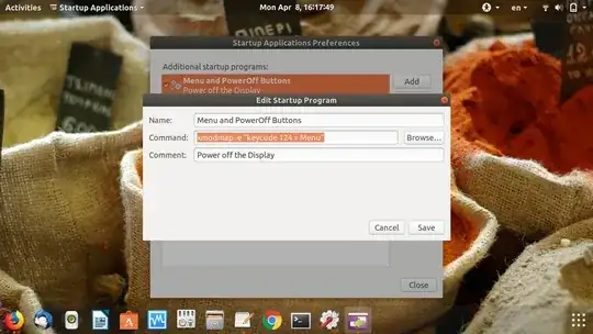

the command xmodmap -e "keycode 124 = Menu" will not survive logout or reboot.
So, Create a startup preferences with command xmodmap -e "keycode 124 = Menu" like below and then Reboot.
When ever you want to remove this mapping, just delete the entry from startup preferences.
