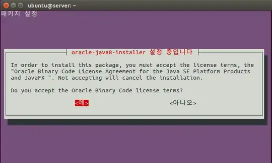

but I had a lot of errors, so I fixed and reinstalled them, but now it shows this image:
screenshot from running apt
