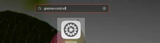

When I invoke the gnome-control-center from the search bar
searching for "gnome-control" in the Applications menu
The true command which the os runs can be found in ps:
me@alpha:~$ ps -ef | grep gnome-control-center
me   13952  7293  0 12:20 tty2     00:00:00 gnome-control-center
me   15523  7835  0 12:27 pts/0    00:00:00 grep --color=auto gnome-control-center
It indicates that the operating system opens a terminal tty2, inputs command gnome-control-center, and presses Enter.

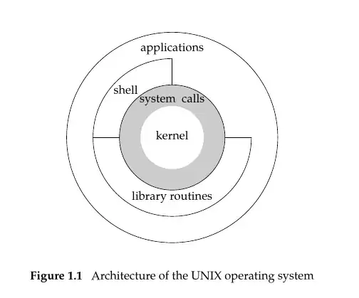

Note:
Thanks for Sergiy's tutorial about Kernel.
I got the idea intuitively from a picture from a book called "Advanced Programming in the Unix Environment".
The system call fork is to spawn a new process which could be called from shell or from applications.
diagram from book
