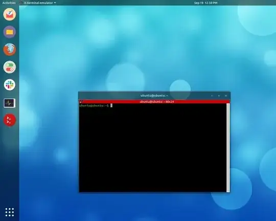

I couldn't get the other methods to work in Ubuntu 19.04 so I resorted to editing the gtk.css file:
nano ~/.config/gtk-3.0/gtk.css
Here is the code I used:
/* add a 3-pixel border around windows */
decoration {
    border: 5px solid rgba(10, 10, 10, .3);
    background:rgba(10, 10, 10, .3);
/* customize the titlebar for active window */
.titlebar {
    background: rgba(10, 10, 10, .3);
    border-top:solid 1px rgba(10, 10, 10, .3);
    color:white;
/* customize the titlebar for background windows */
.titlebar:backdrop  {
    background: rgba(10, 10, 10, .5);
    color:white;
Once the file is saved, run this command to apply your changes:
setsid gnome-shell --replace
See below for the final result.
Gnome on Ubuntu 19.04 with windows that have transparent titlebars and borders
