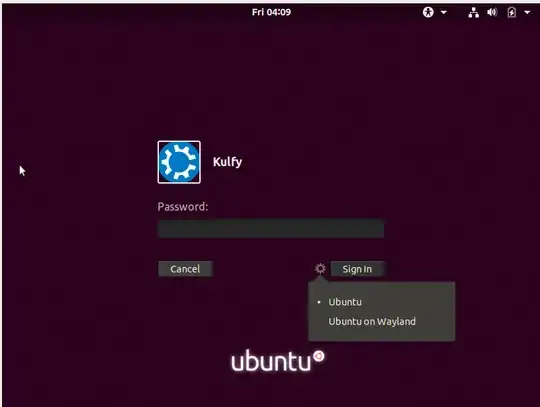

As of now you can switch to "Wayland" and xkill seems to work normally under Wayland. To switch to wayland, click on gear icon and select "Ubuntu on Wayland".
