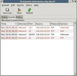

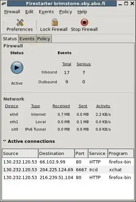

Firestarter has always worked well in my opinion. It supports a robust GUI and supports all options of iptables.
statusevents
sudo apt-get install firestarter

Firestarter's still in Raspbian Stretch at least. If you look at https://netfilter.org/ which is the effective homepage of iptables it's copyright 2014, the task hasn't changed. Iptables probably isn't changing. There is such a thing as maturity in software.
There are 233 repositories on Github mentioning Firestarter https://github.com/search?q=firestarter. What's in Raspbian Stretch is Firestarter 1.0.3 copyright 2005 by Thomas Junnonen. There are undoubtedly forks of the original Firestarter, I'm happy using the original.
I'd be wary of oversimplified software that may leave out useful features. I've been studying iptables for a day or so, I just wanted a "second opinion". I'll take what Firestarter comes up with and use it as a starting point. I'm impressed that it recognized my internet connection EasyTether and seems willing to build NAT stuff for wifi. I have an old DSL router I'll probably use for output, I just wasn't sure how to bridge from EasyTether to the router. Iptables can do it, if it's at all like OpenBSD's pf. Not a typical application, glad Firestarter wants to solve the problem. It's Gnome but nobody's perfect. Works fine in LXDE with some Gnome libs installed.
Firestarter homepage, found in help -> about http://www.fs-security.com/ Yeah, OK, it's maybe a little flaky. I can't get to his official download page. More importantly I can't see the iptables code it generates. It doesn't copy, it doesn't run, it considers the gateway I'm actively using to be offline.
