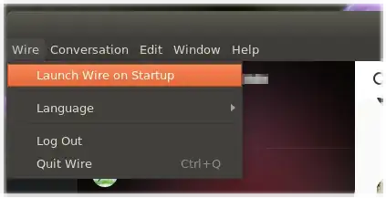

More recent versions of the Wire desktop client have an option to launch it on startup:
