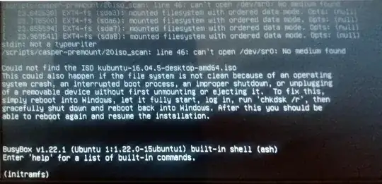

Unfortunately my process is stuck to a point where I get a message saying it could not find the ISO file. This seems strange enough since it clearly shows messages from the kernel. So, I guess it actually reads the files from the ISO file (where the previous file reside anyway). The actual message is this one (it's obviously a photo and not a clear one too): screenshot
Acccording to this answer my system is halted at the stage of mounting my root filesystem which in my case means the ISO file I guess.
The message:
...can't open /dev/sr0: No medium found
refers to my DVD drive and it's something like a bug (I have found some information about this one but lost the source to provide it here) I guess which I am not sure it has something to do with the actual problem here.
I have taken some action suggested elsewhere like booting into windows and using shutdown /s to have a clean windows system (although I am not sure I need a clean window system in this case anyway).

You use the wrong path to your .iso-file in the linux-command:
linux (loop)/casper/vmlinuz boot=casper iso-scan/filename=${isofile}
should be
linux (loop)/casper/vmlinuz boot=casper iso-scan/filename=/home/jorge/Torrents/$isofile
You should also add the parameters noprompt and noeject to this line:
linux (loop)/casper/vmlinuz boot=casper iso-scan/filename=/home/jorge/Torrents/$isofile noprompt noeject
to prevent being prompted to remove the installation media when the installation is finished and the machine is going to be rebooted.
