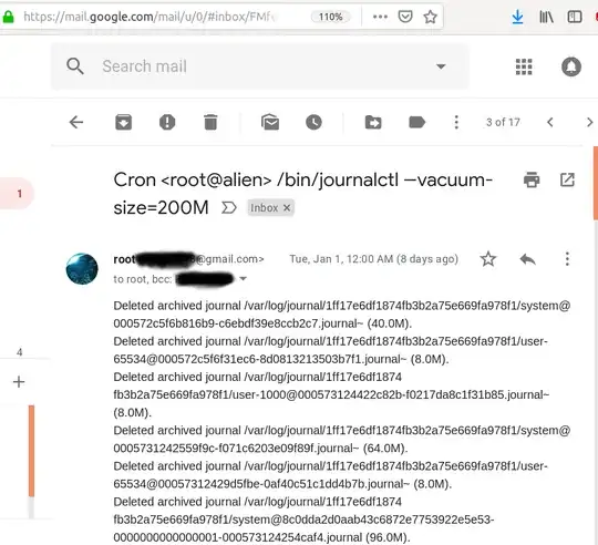

However I only received the following e-mail on January 1st, 2019 saying the job has finally run. I don't recall receiving an e-mail after setting the job up in April 2018. Why is this monthly job only running on New Year's Eve? :

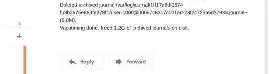

At the very end it says 1.2 GB of space was freed. However it means about 1 GB was wasted until the job ran on New Year's Eve.
The reason the job only ran on New Year's Eve is all the other first days of the month your machine was shut off at the stroke of midnight.
The easiest way is to not use sudo crontab -e but rather create a bash script in the directory /etc/cron.monthly. Make sure the script filename doesn't contain a . in it. Filenames containing a . such as Monthly job.cron or MonthlyUpdate.sh will not run.

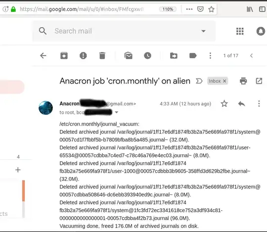

Once per month is unpredictable. The cron job was setup on January 9, 2019 and then ran on January 30, 2019:
Hopefully the cron job runs again on Feb 1, 2019 as anticipated!
