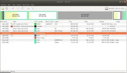

Here's the screenshot of my gparted window, I want to increase the size of my ubuntu partition (60.41 GB) using the unallocated size.
How do I achieve this? I have dual boot with Windows 10.
ss of gparted

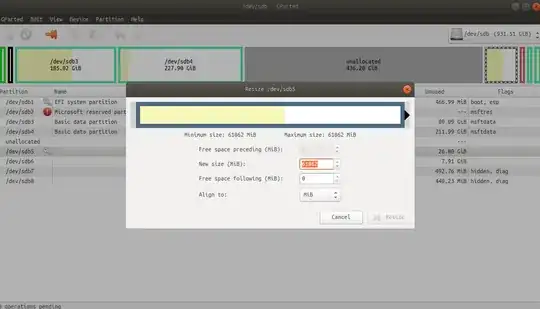

Edit: My resize option is showing disabled for ext4 even though I have unallocated just above it. Should it be below it? If yes then how do I achieve that?
ss of resize

You need to move it first, just grab the partition and drag it to the left, then resize it.
