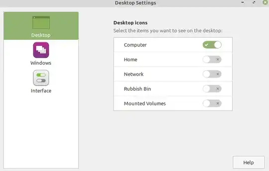

If you are on Ubuntu 19+:
1) Go to your menu and search for a program called [Desktop Settings] or [Desktop Icons]
screen
2) Slide mounted drives so it is greyed out
