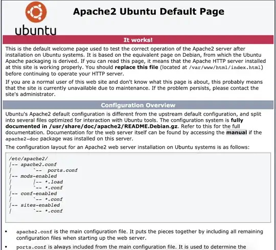

And the website has "Apache2 Ubuntu Default Page"
This is the screenshot on the website "Apache2 Ubuntu Default Page"

Have you tried disabling Apache before running nginx?
I'm admittedly a noob at server administration, but when I've tried installing nginx with apache running I've had similar issues.
Could explain the Apache default page -if your expecting an nginx default page anyway.
Try stopping apache and attempting to install nginx again
sudo systemctl stop apache2
If that helps, you may need to disable apache so it doesn't run again on its own, if that's what you intend.
See this thread if you want to disable Apache all together: How to disable apache2 server from auto starting on boot
