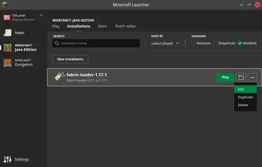

Open up the Minecraft launcher, and go to the Installations tab. You'll have to do this with each installation, which is fine for me since I usually play on the latest Fabric release.
Installations Tab, Hovering over "edit."

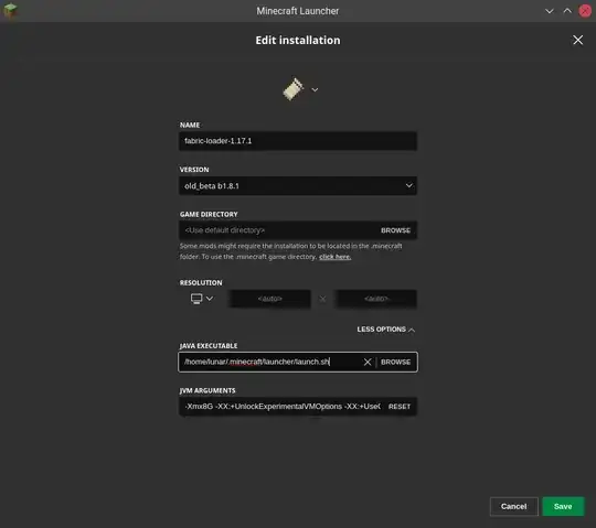

Once you've hit Edit, you'll want to hit the MORE OPTIONS submenu at the bottom, and change the Java executable path.
The "more options" submenu, highlighting "Java Executable"

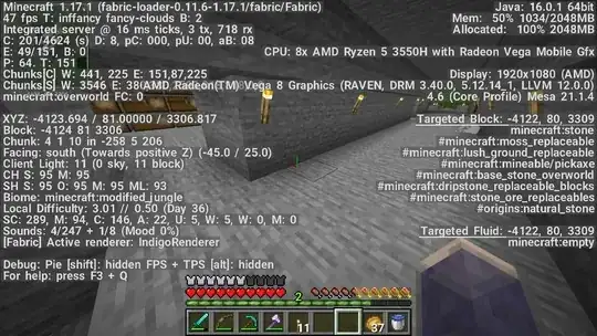

Find the script from above, and set it as the new "executable." Load up the game, join a world, press F3 and double check that it's using your Nvidia GPU!
Without the GPU: enter image description here With the GPU: F3 debug menu, showcasing the GPU being used. (To notice the differences, look at the top right for the hardware list.)
This is more of a hack than anything, but it works and now I can play modded and stream without my laptop dying on me. I hope this helps everyone well.
