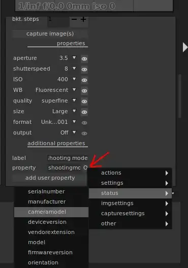

Well, apparently darktable - which I saw, but I got confused that it had only a few of the camera parameters; then I saw https://www.darktable.org/usermanual/en/camera_settings.html and got even more confused, because it showed some properties that my darktable didn't show, but my camera had according to gphoto2 --list-all-config. And it turns out - you can add all/any of the settings manually, by clicking that very missable circle:
darktable
... right next to "property" under "additional property" under "properties". Also, my camera didn't want to accept most parameters until I set it to manual mode, which I could only find and do in camera-config-gui.py
