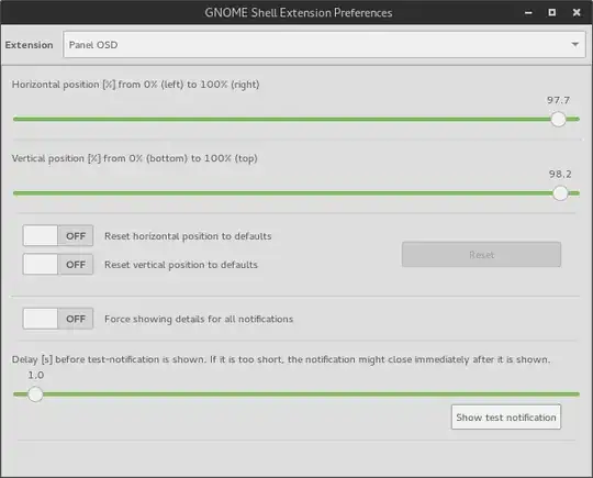

By default it shows the notifications on the top of the screen in the middle - using the settings (these can be opened from the extension's webpage or Gnome Tweak Tool) this can be changed to be on the top right: extension settings window
