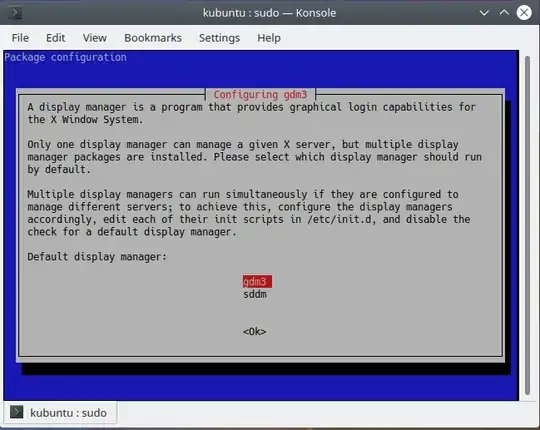

    • Install GNOME and gdm3:
      sudo apt install ubuntu-desktop gnome-shell gdm3
    • Choose gdm3 as default and reboot system.

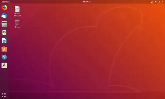

    • You'll be welcomed by GDM. Choose Ubuntu as your desktop environment.
    • Welcome to the "default Ubuntu".
