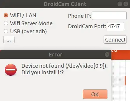

while I am trying to run DroidCam it shows as here:
Error
How can I get rid of it?

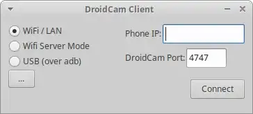

Secure Boot in your BIOS should be disabled for this install to work since it is not signed. Go to the folder where you extracted the DroidCam and run sudo ./install Then you should be able to just type in droidcam from a terminal and run it normally.
Example:
terrance@terrance-ubuntu:~$ cd Downloads/droidcam/droidcam-64bit/
terrance@terrance-ubuntu:~/Downloads/droidcam/droidcam-64bit$ ls
droidcam  droidcam-cli  install  README  uninstall  v4l2loopback
terrance@terrance-ubuntu:~/Downloads/droidcam/droidcam-64bit$ sudo ./install
[sudo] password for terrance:
Webcam parameters: '640' and '480'
Building v4l2loopback-dc.ko
make: Entering directory '/home/terrance/Downloads/droidcam/droidcam-64bit/v4l2loopback'
make -C /lib/modules/`uname -r`/build M=`pwd`
make[1]: Entering directory '/usr/src/linux-headers-4.15.0-43-generic'
Makefile:975: "Cannot use CONFIG_STACK_VALIDATION=y, please install libelf-dev, libelf-devel or elfutils-libelf-devel"
  CC [M]  /home/terrance/Downloads/droidcam/droidcam-64bit/v4l2loopback/v4l2loopback-dc.o
  Building modules, stage 2.
  MODPOST 1 modules
  CC      /home/terrance/Downloads/droidcam/droidcam-64bit/v4l2loopback/v4l2loopback-dc.mod.o
  LD [M]  /home/terrance/Downloads/droidcam/droidcam-64bit/v4l2loopback/v4l2loopback-dc.ko
make[1]: Leaving directory '/usr/src/linux-headers-4.15.0-43-generic'
make: Leaving directory '/home/terrance/Downloads/droidcam/droidcam-64bit/v4l2loopback'
Moving driver and executable to system folders
Registering webcam device
Running depmod
make -C /lib/modules/`uname -r`/build M=`pwd` clean
  CLEAN   /home/terrance/Downloads/droidcam/droidcam-64bit/v4l2loopback/.tmp_versions
  CLEAN   /home/terrance/Downloads/droidcam/droidcam-64bit/v4l2loopback/Module.symvers
Adding uninstall script
Adding driver to /etc/modules
Done
terrance@terrance-ubuntu:~/Downloads/droidcam/droidcam-64bit$ droidcam
