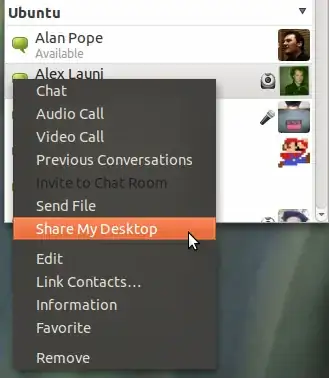

You typically do not need to set up the share desktop feature before you use it. All you need is to make sure that the person on the other end is using Empathy an has "vinagre-preferences" running. Simply right click on the person's name and select "Share My Desktop..."
alt text
You'll get this message while the other person gets a prompt.
alt text
The other person will see something like this:
alt text
When you're done there will be a final message to make sure the person is disconnected:
alt text
If the menu entry is grayed out it means that either the other person doesn't have support for it or you might be using a protocol that doesn't support the feature.
