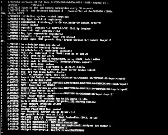

This is MacBook with latest nvidia-340 driver. I had to use power button. (How do you use Magic SysRq key on Macbook keyboard anyway? Even USB keyboard did not work on booting.)
Could this be due to /etc/initramfs-tools/conf.d/resume not existing? I think it is necessary only on resume from suspend to disk (hibernate).
Even recovery boot did not pass. How to boot this thing again?

Your "resume" file needs to contain the UUID of the partition you are using for resuming - it will not exist, if no swap partition has been set or activated. Lately some distros started using swap files instead of swap partitions. In this case the GRUB bootloader has to know where to look when resuming. So you need to find out
  • if your swap partition is enabled (swapon -s)
  • or if you are using a swapfile
See here
But nonetheless I've never succeeded in resuming from hibernate with a nvidia driver. Neither on a laptop or a workstation. Whereas suspend and resuming from it should work.
