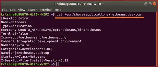

The contents of netbeans.desktop is:
Contents of netbeans.desktop

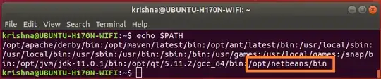

I have put Netbeans binary on PATH by running export PATH=$PATH:/opt/netbeans/bin using ~/.bashrc script file
Netbeans PATH

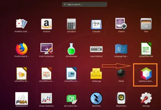

  1. When I click on the Netbeans icon on my desktop, there is just a flicker and the IDE never appeared and nothing happened
    Netbeans Icon

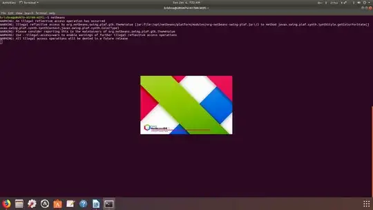

  2. Nevertheless, when I run netbeans in a terminal, I get the following output
    Netbeans Running
    WARNING: An illegal reflective access operation has occurred
    WARNING: Illegal reflective access by org.netbeans.swing.plaf.gtk.ThemeValue (jar:file:/opt/netbeans/platform/modules/org-netbeans-swing-plaf.jar!/) to method javax.swing.plaf.synth.SynthStyle.getColorForState(javax.swing.plaf.synth.SynthContext,javax.swing.plaf.synth.ColorType)
    WARNING: Please consider reporting this to the maintainers of org.netbeans.swing.plaf.gtk.ThemeValue
    WARNING: Use --illegal-access=warn to enable warnings of further illegal reflective access operations
    WARNING: All illegal access operations will be denied in a future release

It seems that the value of Exec in the desktop entry a.k.a. the "shortcut" contains an error. According to Desktop Entry Specification:
The Exec key must contain a command line. A command line consists of an executable program optionally followed by one or more arguments. The executable program can either be specified with its full path or with the name of the executable only. If no full path is provided the executable is looked up in the $PATH environment variable used by the desktop environment. The name or path of the executable program may not contain the equal sign ("=").
Also, UBUNTU_MENUPROXY looks like a user-defined variable which doesn't work in Desktop Entries. So, better remove that and provide the absolute path of NetBeans, i.e.,
Exec=env /opt/netbeans/bin/netbeans #You can also omit "env"
