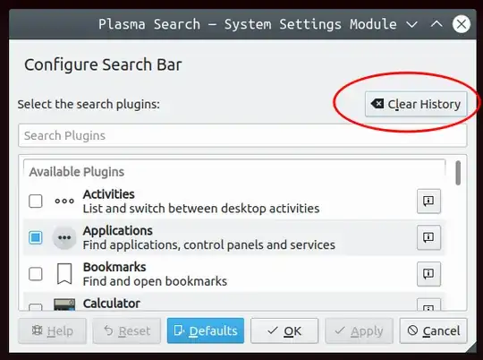

  • Launch KRunner and click on the highlighted icon
KRunner settings
  • In the new window that opens, click on Clear history
Clear KRunner history

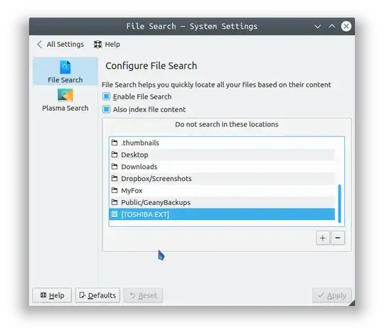

It maybe possible to use the GUI provided by System Settings > Search to remove the desired location from the list of excluded items.
In the image below, a USB drive, "TOSHIBA EXT" is not being indexed.
Excluded device
Be prepared for some heavy CPU/RAM usage until the device is fully indexed!
