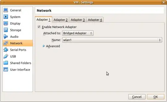

  4. Configure VM to use bridged adapter networking
    bridged networking
    and determine host IP with any method you like (from ifconfig or something).
