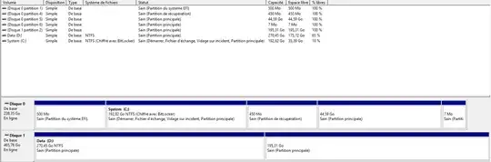

Disk partitioning with ESP, Principal partition for C drive & principal partition for <code>/</code>

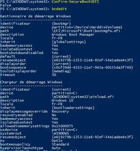

I assume there is also something to do with bcdedit, but I'm not very familiar with it and I'm afraid I could break the entire system messing with it.
bcdedit content
