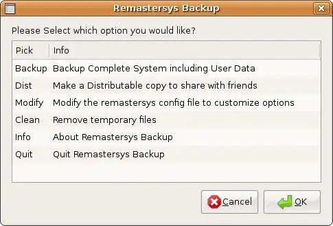

Remastersys is a program that can create backups of your entire hard drive and then save it to a LiveCD, for example. You can also use it to create a custom Ubuntu distribution. It has a CLI and a GUI, so take your pick. In the GUI, choose the first option, Backup.
Remastersys
To install it,open Software center Then Edit -> Software Sources -> Other software (Tab) and click add and paste
deb http://www.geekconnection.org/remastersys/repository karmic/
Now close the software sources window and wait for repos to be refreshed and install remastersys.
