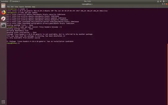

Ubuntu is having trouble finding generic linux headers for 4.10.0-28. What can I do to resolve this?
screenshot

The current kernel version for your system is 4.10.0-28 which was shipped with 17.04 Zesty while 18.04 Bionic is shipped with 4.15.xxx... That's the reason why you're getting this error. Try installing newer kernel such as 4-15.0-43 (as of now this is the current kernel in my main installation). First of all determine which kernel you install from repository. For this run:
sudo apt update
apt-cache search linux-headers
And install that using:
sudo apt install linux-headers-4-15.0-43
You can replace 4-15.0-43 with any of the version available.
To know which Ubuntu version has which kernel version, see @Rinzwind's answer on List of Ubuntu Versions with Corresponding Linux Kernel Version
Kulfy
  • 18,154
The better way would be install both standard kernel image, its headers and all necessary tools with:
sudo apt install linux-image-generic linux-headers-generic linux-tools-generic
then reboot and use them.
Such method will install all needed dependencies and make your system more secure by using supported kernel version.
