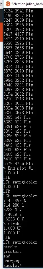

EDIT: after the suggestion in comments, I tried to use set term postscript. The output is different, but still no plot...
plot output after set term postscript
