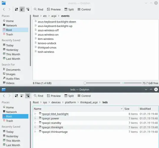

Checking this https://www.thinkwiki.org/wiki/Microphone_Mute_Button.
Thinking perhaps I can apply the same technique to the Volume mute button I checked these two locations and have this.
Is there anything I can do here in these folders?
