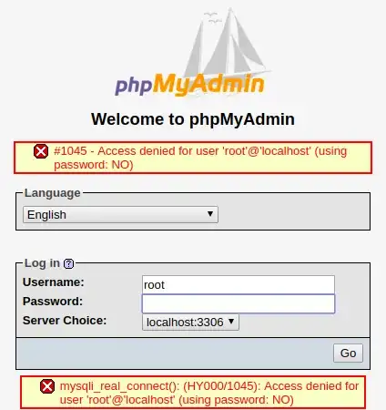

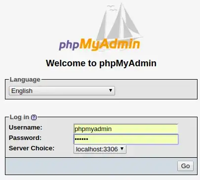

I've installed MySQL and during installation I was asked for a password which I entered, but now my teacher says that we should be able to log in as root without any password.
This works but I don't get any privileges:
login prompt username phpmyadmin
This doesn't work:
login prompt username root, password has been entered, no access
Neither does this
login prompt, username root, no password, no access

Cause of the issue
The default configuration for logging in as root user in MySQL 5.7 requires use of an authentication socket. This can be verified via querying the user table:
mysql> select user,authentication_string,plugin from user where user='root';
| user | authentication_string | plugin      |
| root |                       | auth_socket |
1 row in set (0.00 sec)
From the documentation:
The socket plugin checks whether the socket user name (the operating system user name) matches the MySQL user name specified by the client program to the server. If the names do not match, the plugin checks whether the socket user name matches the name specified in the authentication_string column of the mysql.user system table row. If a match is found, the plugin permits the connection.
In other words, mysql by default doesn't have root password set - you need to either run phpMyAdmin as root or via sudo (both of which are bad idea for security reasons), or you change the authentication method and reset the root password as shown in Digital Ocean tutorial.
Note that aside from same name, MySQL users and system users are not the same. You can have a MySQL user jdoe and have no such user on the host system. Thus, root is MySQL's root user, not system user.
