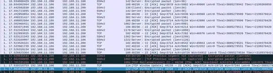

I've also used wireshark to capture the transactions, and it looks like one of the last things that is done before the connection freezes is to send a [TCP Window Update] from the client to the other end (in this case ... 192.168.11.200).
Wireshark Capture of 'ls -la' over ssh connection over vpn
