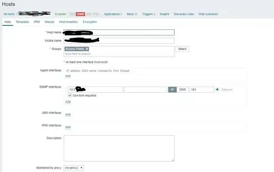

Then I set up the Zabbix dashboard side. I will attach pictures of the set-up.
1st zabbix dashboard menu:

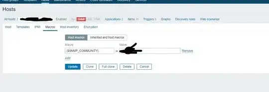

2nd dashboard set-up menu:
I get the following error:
This is a picture of the error I receive.

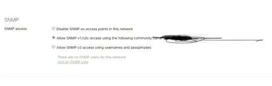

I will also attach picture that shows my meraki access point set-up.
Meraki AP SNMP set-up:
Meraki AP SNMP set-up.

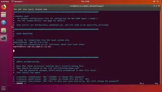

Lastly, I will add a picture that shows the Linux Zabbix server terminal set up on that config file.
Linux Zabbix Server:
Linux Zabbix Server
