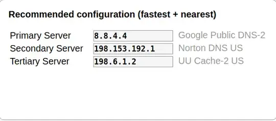

namebench makes thousands of queries and takes a few minutes to complete; please be patient. When it completes, a report will be prepared that illustrates the fastest available nameservers. Here is a sample from my machine:
Saving report to /tmp/namebench_2018-12-24_1436.html
When we examine the saved report, we see:

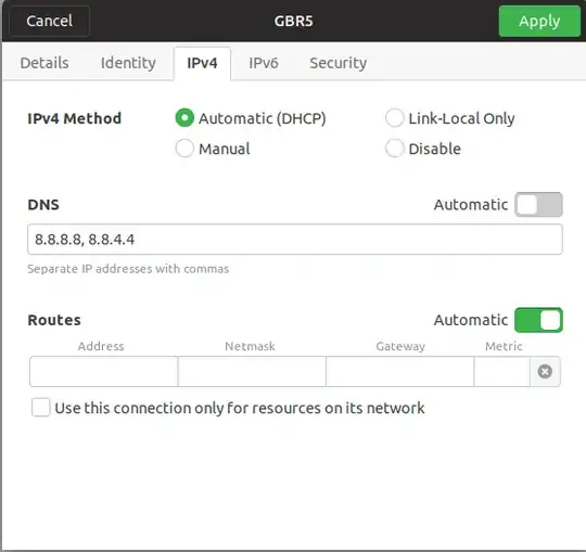

Once you know the two or three most ideal nameservers, apply them in Network Manager's settings like this:
Turn DNS Automatic to off. Insert the IP addresses of the preferred nameservers, seperated by commas, click Apply and close.

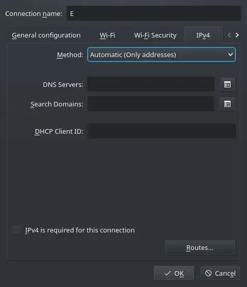

  1. Right click on the network manager icon in the panel and choose "Edit connections..."
  2. Select your connection from the wired or wireless tab, choose "Edit"
  3. (Enter your password if the connection is set as "system-wide available")
  4. Choose IPv4 settings tab
  5. Switch method to "Automatic (DHCP) addresses only"
  6. Enter the name server you want in the box "Additional DNS servers" and press "Apply"
Network Configuration Window
