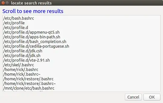

locate GUI front-end glocate
Although locate is a CLI command I've created a GUI front for it using zenity. This is an initial "no frills" front-end that could be improved using yad instead.
Enter up to 10 search file names / directory names
This screen appears when you start glocate:
You can enter directory names and filenames in whole or in part.
Results returned in scroll box
glocate takes about a second to display the results in most cases:

Main () {
    Init
    while GetSearchNames ; do DisplaySearch ; done
Main
Save the file and exit gedit.
Mark the script as executable using:
sudo chmod a+x /usr/local/bin/glocate
If you want to create a desktop shortcut see: An easy way to create a desktop shortcut?
To call the script from the terminal simply use: glocate.
