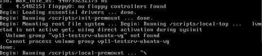

I cloned my Ubuntu Server to a virtual machine on my laptop to do some tests. I adapted /etc/fstab and network configuration but I am unable to get rid of LVM. While the original server uses LVM, the clone has a single partition setup:
$ lsblk
NAME   MAJ:MIN RM  SIZE RO TYPE MOUNTPOINT
sda      8:0    0   64G  0 disk
└─sda1   8:1    0   64G  0 part /
sr0     11:0    1 1024M  0 rom
However, this is still showing during boot:
Volume group "vp11-testsrv-ubuntu-vg" not found
Cannot process volume group vp11-testsrv-ubuntu-vg
Volume group not found; Cannot process volume group
(I am sorry to post a screenshot of text. Is there any file where I can find these boot messages? I cannot find them in /var/log and the output of dmesg.)
It’s probably just a warning and the boot continues successfully but I want to get rid of the LVM traces. How can I achieve this?
The commands pvs, vgs, lvs showed nothing and I even ran sudo apt remove lvm2 without problems but the boot messages are still there. I also removed lvm from GRUB_PRELOAD_MODULES in /etc/default/grub and ran sudo update-grub. I have only found traces of the server’s LVM in /var/log (old records from the original server) and the archive and backup subfolders of /etc/lvm.

It turns out that the traces of LVM were stored in initramfs. I found the question Can't find LVM root dropped back to initramfs and ran the mentioned command:
sudo update-initramfs -u -k all
Since that, the messages regarding LVM have no more been appearing during boot.
