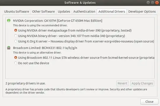

I am using the nvidia-driver-390 driver currently.
Driver installed from "additional drivers"

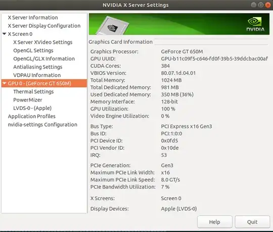

  2. I can see in "Nvidia X Server Settings" that my GPU utilization spikes to 100% 100% GPU usage auuugh!

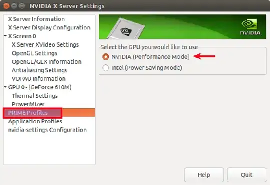

There is also another issue with nvidia-settings, which is that it does not display a "PRIME profiles" tab, as shown in other guides actually has prime profiles :(
The lack of prime-select not doing anything might be related to missing "prime profiles" tab, though I'm not sure.

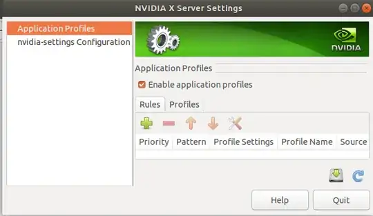

For what it's worth, if I reinstall just the nvidia-settings package then the "Nvidia X Server Settings" application becomes much simpler enter image description here
