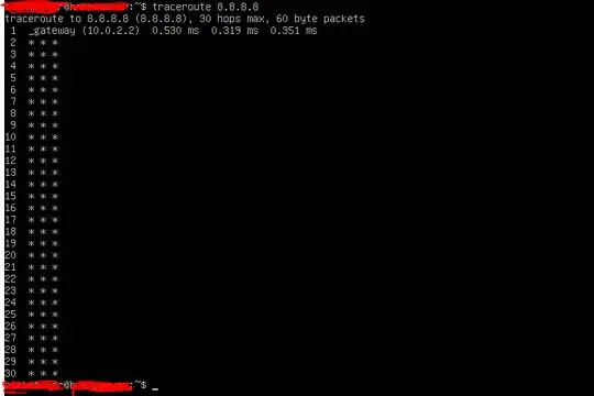

This is what I get when using traceroute 8.8.8.8:
traceroute screenshot
The host OS is Windows 7. This made me really confused. I have to say I am really new to Linux, have been using Linux Unity for only around the last 6 months.
At first, I thought 10.0.2.15 is my IP address but I can’t SSH into the VM through PuTTY using it. The only way I can SSH is through port forwarding in the VM and then using 127.0.0.1 through that port from PuTTY but the internet does not work through this process and as expected it will work only on the host os, not outside.
To open Portainer I have to enter https://serverip:port, but what is my server IP? And why can’t I ssh into my VM?
P.S. If I use 10.0.2.15 in putty then it says connection refused and the other "inet's" give connection timed out. I even went as far as to install Openbox and Firefox to check Portainer and localhost:port worked flawlessly... but only inside the VM.

Wow after so much tinkering, I was able to solve the questions 1,2,3 and 4. maybe it was a very easy thing and i made it complicated for no reason. any way thanks @George Uderson for the website it helped a lot. here is what i did
1) I opened network settings in vm and opened the port forwarding tab. gave a name and put host ip as 127.0.0.1 , port as 22 or anything really, then put guest ip as 10.0.2.x whatever it is and port as 22. open putty and put ip as 127.0.0.1 and port 22 and voila! you are in
2)For this its better to have a fixed ip address of your pc running the vm. i changed it easily in the network properties in win 7. then we can follow the previous step but in place of 127.0.0.1 we put our fixed ip address. then we can use that ip address in putty easily.
3) do same as step 2 or 1 but in place of ports we put the ports used by the container i.e. xxxx
4)same as 3 but only with fixed ip address.
5)dont know how to make that work out of home network.
please correct or edit if i am wrong somewhere. but this worked for me. thanks
