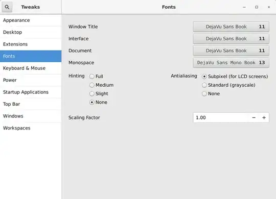

I disabled font hinting in Gnome tweaks, but Firefox sometimes (for certain fonts I think) ignores that and tries to align glyphs to pixel grid, resulting in uneven spacing between letters and/or distorted glyphs. I'd like to force Firefox to never use hinting, if possible, are there ways to do so?
Font settings in Gnome tweaks: Font settings in Gnome tweaks

Just to check it with something really obvious, I tried to disable font antialiasing in Gnome tweaks (which makes fonts obviously hideous) and it doesn't change font appearance in Firefox, so I'm pretty sure Firefox ignores Gnome font settings.
Creating ~/.fonts.conf with the appropriate contents also had no effect in Firefox.
