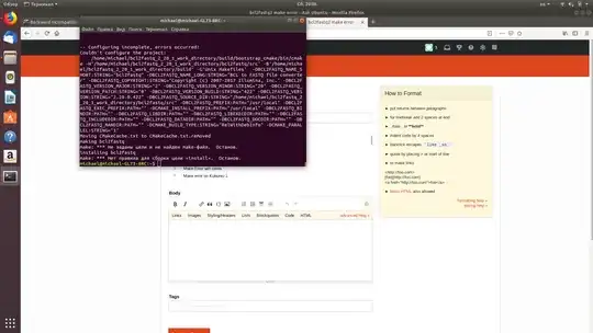

Image of message i get when trying to install bcl2fastq2 library to use with the Cellranger 3.0.1 software
screenshot
So I already installed all dependencies and checked them in terminal, but still while trying to install bcl2fast i get this, and i can't figure out what and hot toconfigure to make it install. In image it says in russian "make file not found. Help me please!
I tried to use script from here to install bcl2fast.
I use Ubuntu 18.04 and my computer meets min sysreq for this software!
Thank you further for your help, will wait for any information that can help!

After spending a couple of hours trying everything...
I solved the issue in Ubuntu 18 downloading the .rpm package from here: bcl2fastq2 Conversion Software v2.20 download
Then converting to a .deb package and installing:
sudo alien bcl2fastq2-v2.20.0.422-Linux-x86_64.rpm
sudo dpkg -i bcl2fastq2_0v2.20.0.422-2_amd64.deb
