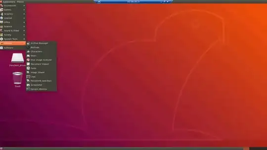

I followed Griffon's guide to install xrdp on Ubuntu 18.04 (http://c-nergy.be/blog/?p=12761) but modified /etc/xrdp/startwm.sh to use it with gnome-flashback-metacity:
#test -x /etc/X11/Xsession && exec /etc/X11/Xsession
#exec /bin/sh /etc/X11/Xsession
#gnome-session
gnome-session --session=gnome-flashback-metacity --disable-acceleration-check & gnome-panel
I could log in from Windows client (session: Xorg) but the desktop seems to be missing various items in Applications menu (particularly Terminal), as well as the indicator icons. I could start gnome-terminal using the "right-click on Home, Open in Terminal" trick.
messed-up gnome-flashback-metacity
NB: Based on past experience, I believe this might be related to permissions. However, I cannot tell if this is a problem with xrdp or GNOME Flashback or just bad config on my part. Regular login at the physical machine works just fine.

Turns out to be a case of bad config and misunderstanding of how the GNOME Flashback environment is normally initialized. After looking through the related configuration files - /usr/lib/systemd/user/gnome-session.service and /usr/share/xsessions/gnome-flashback-metacity.desktop, I came up with the following modifications to emulate the same behavior for xrdp:
/etc/xrdp/startwm.sh:
# these global variables are set during normal login through gdm greeter
export DESKTOP_SESSION=gnome-flashback-metacity
export XDG_CURRENT_DESKTOP="GNOME-Flashback:GNOME"
export GDMSESSION=gnome-flashback-metacity
export XDG_SESSION_DESKTOP=gnome-flashback-metacity
These exports should be set somewhere before . /etc/X11/Xsession (when the xsession gets started)
~/.xsession:
# starting the session through systemd, just like normal login through gdm greeter
/usr/lib/gnome-session/run-systemd-session gnome-session-flashback.target
Running gnome-session command directly was causing the indicator icons to not show up (similar to Gnome-panel applet "Indicator Applet Complete" is missing icons). So while this has been addressed with the use of run-systemd-session, I haven't identified the portion that starts gnome-panel (the panel that houses the indicator icons) during normal login, so for the xrdp xsession, I had to add gnome-panel to Startup Applications.
