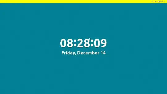

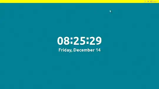

However, I don't want to see those transient 3 upward scrolling arrows on the screen at 08:25 34th second & 40th second. above the date feild Friday, December 14 in the animated gif.
How to achieve this?
