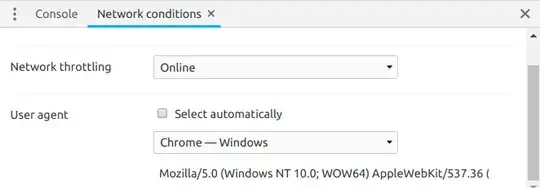

  • Open New Tab and press Ctrl+Shift+I to open Developer Tools
  • Click on Hamburger menu (vertical dots) and choose More tools - Network conditions
    Enable Network Conditions
  • Go to the Network conditions tab (should appear in bottom right), disable the option Select automatically and choose Chrome - Windows from drop-down menu.
    Select other UA
  • Note: You need to perform all things again once WhatsApp web is opened in new tab or Chromium is relaunched since Settings are applied only for that Tab and aren't remembered for a particular site.

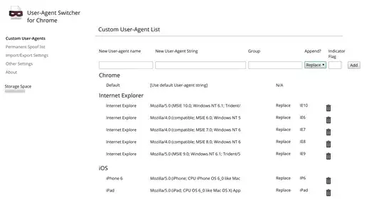

2. Using an extension:
  • Download and install User-Agent Switcher for Chrome
  • This extension doesn't have any User agents for Chrome. So, you need to add a new custom User Agent or use in-built user agents, for example, Internet Explorer/Safari/Firefox.
  • If you want to stick to "Chromium on Ubuntu" as User Agent:
    • Right Click (or two finger tap) on the extension in top bar and click on Options
    • A list will open which would look like
    Options Page
    • Click on New User-agent name. Give any name you like and as User-agent enter this Mozilla/5.0 (X11; Linux x86_64) AppleWebKit/537.36 (KHTML, like Gecko) Ubuntu Chromium/73.0.3683.75 Chrome/73.0.3683.75 Safari/537.36. Give group name as Chrome, in Append?, choose Replace and in Flag field enter New. Click on Add.

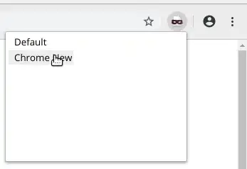

  • Now, click on extension in top bar and change the UA to this newly created custom UA or some other UA (if not created).
    Setting UA
  • In this case UA is applied universally to all tabs.
