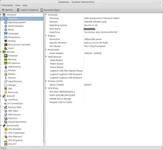

The best native tool is HardInfo System information and benchmark tool.
Benchmarks
HardInfo comes with the following benchmark tests:
CPU Blowfish
CPU CryptoHash
CPU Fibonacci
CPU N-Queens
FPU FFT
FPU Raytracing
Highlighting any test and then selecting 'refresh' from the top toolbar will rerun any previously completed benchmarks
https://help.ubuntu.com/community/HardInfo enter image description here Found a couple of others
