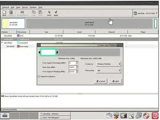

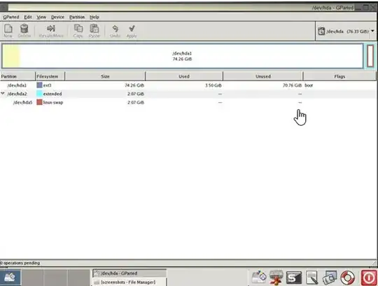

You will get a GUI and most probably the icon for GParted will be in the top left corner. Once you open that up you will get a screen such as this.
Next select the partition you want to extend. You have to make sure the space you have free is to the right of the partition. If you have more than one you have to shuffle other partitions further to the right until you get a free space there. Also if you do need to resize another partition (Part B) to the right of the partition you are looking at originally (Part A) remember to save changes in between as otherwise it will not allow you to extend you Partition A as Partition B is still in the way until you commit changes. This is the kind of screen you will get while resizing. enter image description here
