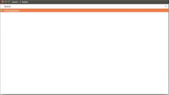

Uget was working fine until one day suddenly everything disappeared from the uget screen.
This is how it looks now. enter image description here
I uninstalled it twice and reinstalled it only to see this exact screen. I can't understand if it is downloading or not in the background.
My pc runs on Ubuntu 16.04

It seems config files of your uGet got corrupted somehow.
If you can afford to do that (you'll lose all uGet configurations), remove the broken config files, i.e. remove the ~/.config/uGet/ directory while uGet is closed and then launch the application.
