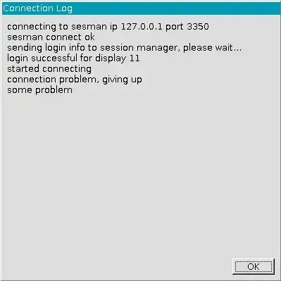

I have enabled root login on Ubuntu 18.10 with gnome desktop, works fine. I also have installed xrdp, and it works fine for normal users but not root. I am facing 3 issues:
  1. I want to enable remote login for root. When I try to login, I get this message below
this error message

You need to add a password for root if you have not done so:
sudo passwd
Then you can use username root and password to log in.
just an idea but worth trying...
Issue 1 - Allow root Login
I think that by default xrdp does not allow root to perform remote desktop connection.... you should have a look at the following file /etc/xrdp/sesman.ini and check if there is any AllowRootLogin option. Set the value to 1,true or yes to enable root login on terminal server
