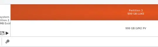

Using the Disks application:
In Ubuntu 18.04 or newer there is the possibility of using (Gnome) Disks. Thanks for the hint, Greg Lever, after clicking around I found what Greg mentioned:
  1. Open Gnome Disks.
  2. Choose/Click on the main physical hard drive in the left panel.
  3. Click on the LUKS encrypted partition, in this example it is Partition 3: Screenshot Gnome Disks
  4. Click on the edit icon (cogs, gear wheels) and choose "Change Passphrase".
If you get an error, close GNOME Disks and open it in a terminal: sudo gnome-disks
(This helped @ScriptAutomate, thank you for the tip.)
