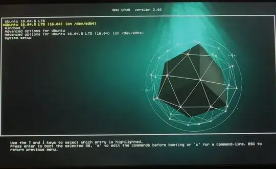

Although you cannot restore directly to 16.04 from within 18.04, you can install 16.04 in a separate partition and then add it to Grub as an extra boot option, like so.
