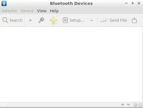

and when I run blueman-manager from terminal, I get this in the logs:
SetAdapter (/usr/lib/python3/dist-packages/blueman/gui/DeviceList.py:271)
No such adapter
Also, almost all buttons are inactive and I can't do anything in the bluetooth manager.
