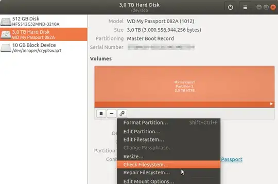

I Check Filesystem with GNOME Disks (gnome-disks) and had some errors. Fixed with the repair option:
screenshot
More info here.
